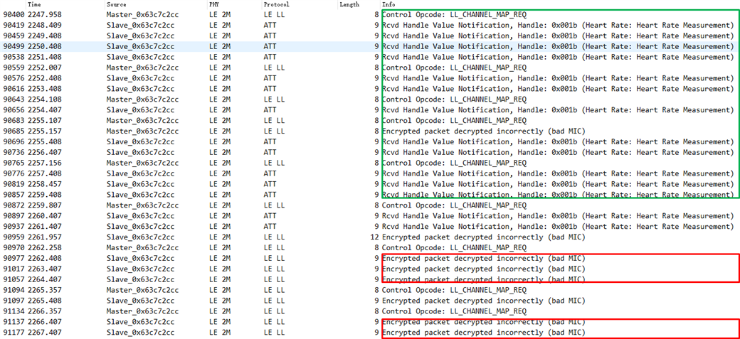

Capture LE Secure connection occurs bad MIC after successfully sniffering the air packets for a while
I tried to build a BLE sniffer environment. And it works well to capture the LE secure connection air packet after Eable Secure Connections debug mode(uses the debug keys specified in the Bluetooth Core Specification)
But I noticed MIC error reported on Wireshark after capturing the connection for a while (sometimes 3-5 minutes,sometimes half-hour)。

    I assume you have applied some filters here, since there are quite a few packets missing (looking at the packet numbers).
    I suspect that there is some packet that the sniffer is missing, that includes some connection update, which causes the encryption to go bad after this.

  • I can't see anything particular in the sniffer trace that you sent me. (Not the same as in the screenshot above).
    In the other one, the packets are decrypted incorretly e.g. at packet 15865, but later, in packet 15868 it is decrypted correctly again.
    It may be that the phone is doing something causing them to use some other key (although that doesn't seem likely, since the sniffer is able to decrypt later).

    I also did the same test with 2 nRF52840DK, one is slave (peripheral_hr) and on is master (central_hr). The issue still occurs, but I can see the communication betwen the 2 paired devices works well from printed log.
    As you can see when the first MIC error occured, as the test running seems MIC occured more frequently. At the final, the sniffer can not capture any data  (lost sync with channel hopping?). But checking with the printed log, 2-paired devices are communicating well with each other.
     Yes. It looses the packets that contains updated channel maps, and is no longer able to follow the channel hopping.
     In that case we can rule out that it is because the phone does something weird.
