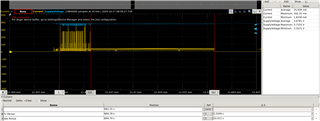

  2. In the following figure, a transmission is captured. It can be seen that there is an idle period ~10sec after the Tx period.
    Searching through the posts I found this and this this in which the Inactivity Timer is mentioned.
    So I guess that this 10 sec period is the inactivity timer set by my network operator.
    Is there any AT command to read the Inactivity timer setting?
    (I also tried to enable the Release Assistance (AT%XRAI=3 / AT%XRAI=4), but I had no luck).

    2. The idle period your are seeing is indeed the RRC Inactive Timer described in the posts you linked, and it is, as you say, given by the network operator. There is unfortunately no way to read this value yet, but your network provider should know which parameters they provide. Capturing a transmission, like you have done here, is also a viable way of determining the timer parameters. We have an online power profiler for LTE where you can read more about the different parameters and see how they affect the device.
