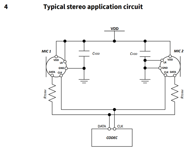

Hello, I try to read from IM69D130 (as microphone) by nRF52832 (SDK 16) , And I work with PDM driver of nRF52. It seems it cannot read the data correctly. Here is my function pdm_event_handle:

nrfx_pdm_config_t pdm_config = NRFX_PDM_DEFAULT_CONFIG(PDM_CLK, PDM_DATA);
pdm_config.clock_freq = NRF_PDM_FREQ_1032K;
pdm_config.gain_l = NRF_PDM_GAIN_MAXIMUM;
pdm_config.mode = PDM_MODE_OPERATION_Mono;
pdm_config.edge = NRF_PDM_EDGE_LEFTRISING;
nrfx_pdm_init(&pdm_config, pdm_event_handler);
nrfx_pdm_start();

  • Also I put a resistor (Rterm=100ohm) in series with data as the datasheet of IM69D130 mentioned, Is it right?
  • You need to inspect the raw PDM samples in memory and compare them with what your string formatter outputs, most likely threre's something wrong in how you process them after they've been successfully sampled.
