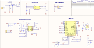

I recently designed a PCB and have been testing it.The PCB mainly consists of the Bluetooth Module BMD-350 ( based on NRF52832 SOC ) and HX711.( There is an accelerometer and RGB-LED as well but we haven't mounted them yet). The schematic is attached herewith:

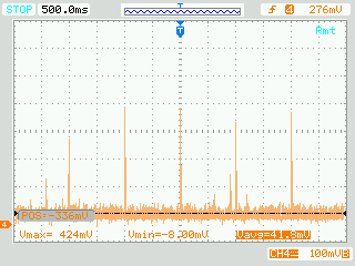

As it is a battery powered device, we wanted to monitor current consumption and hence we connected a multimeter to the device terminals. The PCB is displaying different current consumption patterns:
Generally, every time I power it up, the device goes into either of these two states.I guess state B is the desired behavior. However, out of every 10 attempts on switching on the device, 3-4 times, it enters into state A and consumes high currents, even in sleep mode.And whats even more strange is that sometimes,when device is consuming 9.4mA in state A third mode, after 30 odd secs, it suddenly starts consuming 0.03mA. So the behavior is kind of erratic.
I de-soldered the HX711 section and the strange current pattern kind of still continued which makes me think that the problem is with BMD-350. The BMD-350 has been programmed to transmit in DC-DC Enable mode in active state and goes to deep sleep with sd_power_system_off.
Could you it be the firmware or the floating pins causing this issue ? Has anyone here faced similar problem while testing a device ? Any help will be appreciated ! Thanks.

    As shown in the schematic, we just have the regulator, BMD-350 and HX-711 on the board and out of them,i had de-soldered the HX711 last week just to observe how the circuit behaves. It was still sometimes consuming high current of 11mA in active state and 8-9 mA in sleep state. This makes me doubt that it is the BMD-350 which sometimes is in a confused state maybe !

    I remember him saying that the unconnected / unused pins are not mentioned in FW at all. Can that be a problem here ? Do we have to pull - up /down the unused GPIO pins ?
  • Your engineer is probably thinking feedthrough might be an issue; the nRF52832 is not affected by floating pins left in the default state. Internally these are held (and read) at '0' but without bus loading.
