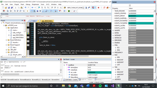

Hi, i am using:
-nRF 52 DK
-nRF 52832
-Sensor of Maxim Integrated
-SDK 17.0.2
I have some problems in handling the I2C through the nrfx module.
My I2C communication with the sensor is defined as a TX/RX.
I am using slightly different Read/Write function than the one used in the NRFX examples because i need some non-void function.
Here is my initialization,handler and read byte function:

I don't receive any error (err_code always 0 (NRF_SUCCESS)) but it seems that after the first transaction (TX) nothing happen as i can see from the TWIM0 window:
No task is started and no byte is transferred.

  • Hello Polimarte!
    From your included screenshot you seem to be encountering some errors. Is this correct? Which errors are these, and where do they come from?
    Are you ever entering your twim_handler?
    Do you have access to a logic analyzer, so you may see what is happening on the pins themselves?
    Please elaborate where you are reading this. From what I can see in your screenshot, both ERROR and TXSTARTED is true - leading me to believe that a TX in fact is started, and an error is returned somewhere.
    Let us start by finding the source of this error, so we may get to the bottom of why this is not working as expected.

  • Hi Karl, it is a pleasure to hear you again!
    I have to admit that i found some problems in enabling the log uart in the last SDK so i am using the RTT viewer but nothing happen on my RTT terminal if i am stack in a loop as in my case.
    My code is stack at the loop for twim_tx_done, so NRFX_TWIM_EVT_DONE is never set.
    If i comment these loop on both the Read/Write Bytes functions on my window, my code run without block and i can see this on the RTT viewer:
    Yes i can enter on the twim_handler and as i can see from the RTT viewer i get : NRFX_TWIM_EVT_ADDRESS_NACK.
    Yes, i do. I am using KEIL. Unfortunately i m still studying how to setup the logic analyzer because i am not able to let it work properly (i am getting always "Unknown Signal").
    Mange Takk Karl!
    polimarte

    Apart from the screenshot you should see a debug output if anything else than NRF_SUCCESS was returned.
    I have the RTT viewer which display the NACK and the TWIM viewer where the TX starts and the AMOUNT of bytes transferred is always 0. Where i can catch and show you other useful debug outputs?
