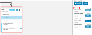

However when I flash my nRF52840 it advertises as DfuTarg and I see only the secure DFU service. I was expecting to see the advertising name I have define inside my application as well as my services along with the secure DFU service.
     This suggests that the bootloader has "rejected" the application, because the bootloader settings are incorrect. Please show me how you generated the settings, and make sure that you used the .hex file that you program into the nRF to generate your settings. If you recompile the application, you must re-generate the settings.

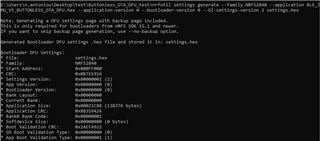

    To generate the bootloader setting file I followed the Generating and displaying bootloader settings and I used the following command
    nrfutil settings generate --family NRF52840 --application app.hex --application-version 0 --bootloader-version 0 --bl-settings-version 2 settings.hex

    Xmm I am not sure. I remember that I generated the settings file after I modified and compiled the applicaiton file but I think that I've dove some additional changes in a later stage (after creating the settings file)
    For that reason I regenerated the settings page now using the latest application:
    and after merging the files I flash my target and voila!!
    It seems to work!! :) I assume that the issue was with the settings page..
