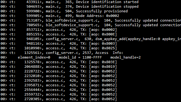

I am evaluating LC example, I am using an occupancy sensor. So whenever there's an occupancy it's detecting and turning the lights ON. But even when there's occupancy the lights are fading after the RUN timer elapses.
I have set the Publish interval on the nRF Mesh App but I couldn't see the sensor publishing it's present state at the set intervals. Please suggest a solution.
