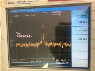

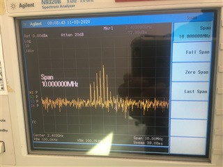

HI,Alseth:
That is example esb-ptx.Every channel,every version's SDK----SDK15,SDK16,SDK17,will be like that.and no about spectrum Analyzer's setting,just like follow two waveform picture,it was taken in esb_ptx example,but the source code for simple frequency picture is only annotating the statement"NRF_RADIO->SHORTS = m_radio_shorts_common | RADIO_SHORTS_DISABLED_RXEN_Msk;" in document nrf_esb.c,here is the two pictures in the same spectrum analyzer setting(and They are in the same channel 3):
Could you enable max hold on the spectrum?
Håkon
Hi,Alseth:
The two picture is just to make a comparision.Could last picture means that is only a carrier waveform?And the first picture could mean that it is a payload waveform?
The first one, with the several smaller spikes, is modulated carrier (ie. a carrier with actual payload data), while the "cleaner" one is a pure sine wave (unmodulated carrier).
If you enable max hold on your spectrum analyzer, you should see a more rounded form on the modulated signal as well.
Håkon
