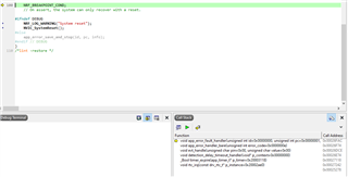

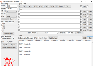

If I press the button after running, the board will re-run.
When the button is pressed during a run in debugger state, the following 'Call Stack' is output:
I think there is something wrong with the button handler and initialization, can you tell me what needs to be fixed?
