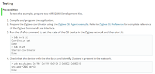

Question) Connect zigbee End-device , Coordinator
I would like to confirm that the temperature measurement is sent from the end-device to the coordinator using the example zigbee temperature sensor.
I'm looking at Testing at "https://infocenter.nordicsemi.com/index.jsp?topic=%2Fsdk_tz_v3.1.0%2Fzigbee_multi_sensor_example.html", but it doesn't connect from the Multisensor(end-device) to the Coordinator after starting as shown in number 3.
Is there anything I'm missing?
And the ep=10 shown in the output in number 4 looks like an endpoint, so can I see it as an endpoint id?

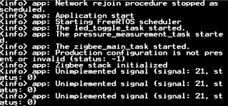

    From your text and the documentation you're referring to it seems like your goal is to use the Multi Sensor example. However, in the output from the sensor it seems like you're using the Multi Sensor with FreeRTOS example instead. Could you make sure that you're using the correct project file for your example, as well as the correct documentation for that example?
    Are you only issuing the "bdb role zc" and "bdb start" commands? If so, what happens if you try to issue the other ZCL commands stated in the documentation for the example? Could you please copy the commands you issue as well as the output you get and paste it here as text. If you're using PuTTY you can copy this by right clicking on the top of the window and selecting "Copy All to Clipboard"

    I knew it wasn't connected using 'free_rtos' as you answered.
    Used as a basic 'multi_sensor' and functioning normally.
