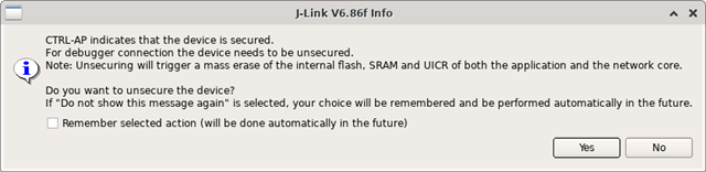

  • Version V6.86f gives different problems. It seems not flash at all.
    It keeps giving a popup saying the device is secured. Regardless whether I answer Yes or No, the SEGGER software seems to hang after this. I am using a PDK version 0.8.0

    Using version 6.86f:
    The behaviour is little different then I had before (Previously I swapped the order of launching)
    When I try to erase the network core using JFlashLiteExe, the device is secured message pops up.
    When I choose yes, the JFlashLite indicated it succeeded.
    When I launch the network core, the popup comes again.
    When I choose yes, the launch fails with "Starting J-Link GDB Server timed out."
    When I choose no, the launch continues, but it seems without flashing, as the application halts at 0xdeadbeee. (rather then waiting for the application core to release the network core)

    Looking at SEGGER's change log, it says
    "Device protect check for nRF5340_xxAA_NET core of nRF5340 series device according to new hardware revision (v0.9.0 or newer), adapted. SECUREAPPROTECT bit only for nRF5340_xxAA_APP core implemented."
    Could it be that this issue occurs because I my PDK is version 0.8.0?
    Yes. I also get an error about the device being protected (on an internal 0.7 version in my case, but that is more or less identical to 0.8), though it can be ignored. I will report that.
