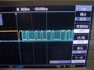

HI all,I am looking for a help.how to start SPIM RX task immediately delay less than 2us?
I have a SPIM test on 52832 DK board(QFAAE0) with SDK16.0, the MISO pin has connected with a GPIOTE pin together,when GPIOTE HITOLO event happened,ppi will trigger SPIM START task,but the bytes received are not correct,because the rx started with 6us delay, in the scope picture the yellow wave is MISO and the blue wave is SCK.I have tested nrf_drv_clock_hfclk_request and sd_power_mode_set(NRF_POWER_MODE_CONSTLAT),but there was not a noticable effect.
my test code are here:
