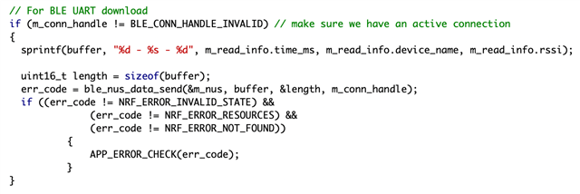

I am currently using the nRF logging module to log data from a nRF52832-DK to my laptop via a serial connection. However, I would like to move over to BLE logging for the sake of convenience. I've been looking at the ble_app_uart example for a while, but I'm having trouble applying it to my specific use case.
Instead of calling NRF_LOG_INFO() to send data to my laptop over a serial connection, how can I implement a similar function to send data to my laptop over BLE?

    So I should have been a bit more precise in my previous comment. The ble_nus_data_send() doesn't really convert the data to ASCII but instead threats the string as an array of bytes. What data types is buffer, and the 3 other parameters that you're passing to sprintf? Also, set a breakpoint after the call to sprintf and watch the buffer variable. How does it look in debug view? Is it correctly formatted? The phone that you use might also affect how the data is printed on the other side.

    The data type of buffer is a string, with 2 ints and a string variable being substituted into the string using sprintf(). I will take a look at the buffer variable in debug view, thanks. I am using an iPhone with nRF Toolbox to view the messages sent by my device.
