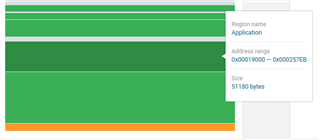

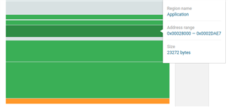

Besides the application, there is a bootloader, softdevice, and bl_settings in memory. My question is if it is possible to do this with the memory that is left?
I know there is a limitation on minimal memory required to do this. Currently, as I see there are 33533 bytes free.
