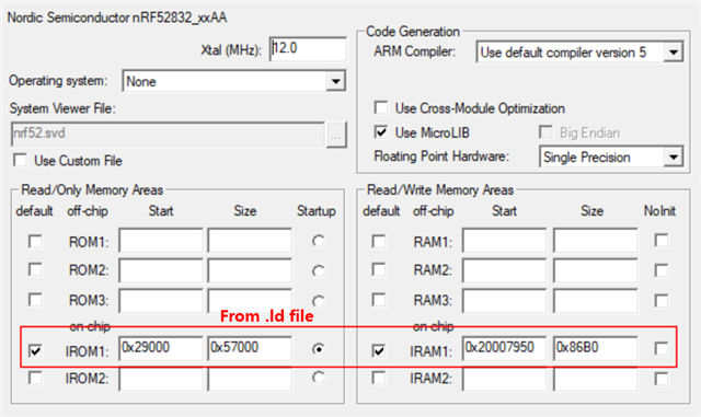

Our products are using gcc+makefile method to compile and generate .hex file, it works fine.
We want to debug product in hardware situation, so we port the project from gcc+makefile to keil.
According to the configuration of makefile and linker file, we added all necessary parameters in options of KEIL.
We didn't change anything of codes. But the startup file was replaced with arm_startup_nrf52.s, not gcc_startup_nrf52.S.

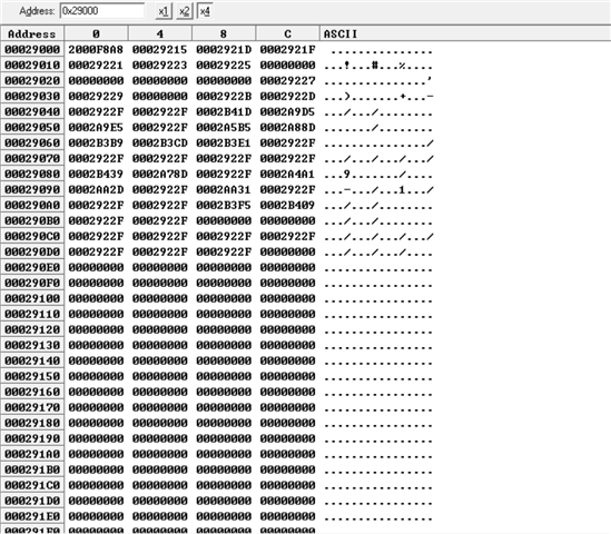

The process of compiling and linking are successful, .hex file was also generated, it sounds good.

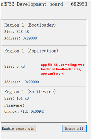

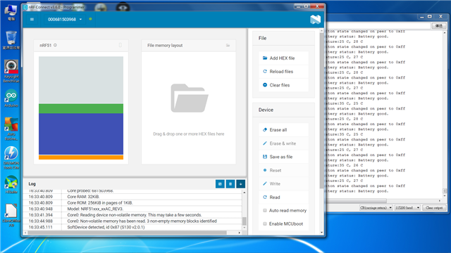

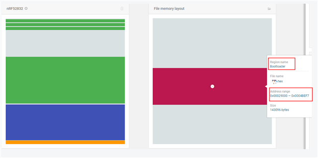

But when we loaded the .hex file generated by KEIL compiler, the application couldn't work.
We found the application was loaded in bootloader area, althoungh we didn't download any bootloader file to chip.

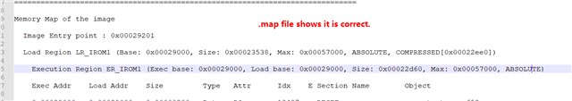

We checked the .map file, it showed all address information are same with we has set.
Here are some detail figures to explain what happened:
Options for keil:
the .map file:
