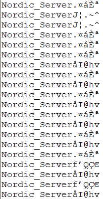

I am trying to get the board advertiser name from the advertising data received by another scanner board. I am using softdevice S140 version 7.2.0.
The server board name is: "Nordic_Server". This is 13 characters. The client board is scanning and printing names of nearby servers. The problem is that data received length is 18 characters (data->len is 18 sometimes and 31 in another times). The rest 5 characters are varied randomly with each new advertising packet. The server and client are running versions of ble_app_uart and ble_app_uart_c respectively (Without automatic connection).
This is my code under BLE_GAP_EVT_ADV_REPORT event id:
const ble_gap_evt_adv_report_t *p_adv_report = &p_gap_evt->params.adv_report;
const ble_data_t *data = &p_adv_report->data;
uint8_t * device_name;
device_name = ble_advdata_parse(data->p_data, data->len, BLE_GAP_AD_TYPE_COMPLETE_LOCAL_NAME);
int8_t report = p_ble_evt->evt.gap_evt.params.adv_report.rssi;
device_name[data->len] = 0;
print_string(device_name);
print_char('\n');
These are the names printed on the terminal:
There is always 5 extra characters printed randomly after the server name.
