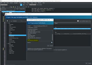

  • Hi Benjamin,
    Do you add SOFTDEVICE_PRESENT into the preprocessor Definitions as the figure?
    The code should work when the SOFTDEVICE_PRESENT is added into the preprocessor Definitions.
    #ifdef SOFTDEVICE_PRESENT
            if (nrf_sdh_is_enabled())
                ret_code_t ret_code = sd_power_system_off();
                ASSERT((ret_code == NRF_SUCCESS) || (ret_code == NRF_ERROR_SOFTDEVICE_NOT_ENABLED));
                UNUSED_VARIABLE(ret_code);
    #ifdef DEBUG
                while (true)
                    /* Since the CPU is kept on in an emulated System OFF mode, it is recommended
                     * to add an infinite loop directly after entering System OFF, to prevent
                     * the CPU from executing code that normally should not be executed. */
                    __WFE();
    #endif // SOFTDEVICE_PRESENT
    -Amanda H.
