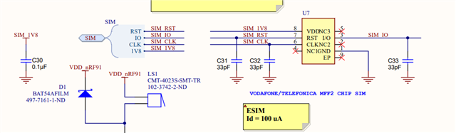

I have some boards that work with nRF9160 and Chipsim.
Some work fine.
Using MQTT application
With two boards I get the errors.
ERROR: getaddrinfo failed 12
ERROR: mqtt_connect -106
No activity on the lines of SIM_CLK , SIM_IO .
In fact they are 0v all the time.
Please Advise.

  • Hi.
    I am currently in preproduction.
    Out of 8 boards 2 of them gives the error.
    It is a custom board.
    Yes, You are right it is eSIM.
    What does it mean Not enough core and Address family not supported by protocol  family ?.
    When I get an assembled pcb, I erase it , program the Cellular modem , and my program ,
    It works fine with other pcb's.
    Attached schematic of eSIM wiring.
    Thanks.

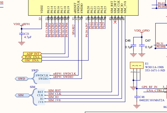

    Only looking at the picture you attacked, the wiring looks fine. But please attach your full schematic (as files, not images) so we can take a look.
    Not enough core means there isn't enough memory available to store the return of the function. The next error is just a consequence of the first one because the application is trying to run mqtt_connect without any address information.
    However, if the issue is only showing up on 2 out of 8 boards, that would indicate a HW issue on these two boards. Possibly a soldering issue or an ESD/EOS issue.
    Check the resistance/voltage drop between all the lines in the SIM-chip, VDD, and ground. If there's a difference between the "good" boards and the boards that don't work, that might point you in a direction.
    You should also try reflowing the board in case it's a soldering issue or a pin has short-circuited.
