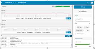

Hello All,
We are testing power consumption  nRF52810 in system ON mode , my configurations as below,
Device will advertise for 10 sec connect with the mobile app sends the and then stop goes to low power mode for 1 minute then advertise again
 and check and change in sdk_config.h the below macro values.
  1. With this the device will start to advertise after 1min . (we can change time by changing value in line no. 774 main file)
  2. The device will send data  after connection (we can change time by changing value in line no. 775 main.c)
  3. The device will disconnect after 10 sec  after sending data (wecan change time by changing value in line no. 776)
Device:nRF52810
SDK: 15.3
profile: BLE_APP_UART
Enabled DCDC mode
During this condition with all peripherals disabled my device is consuming around 300uA during system ON low power mode but expected current as per Nordic is 1-2uA in system mode.  I am conducting the tests using power profile kit. below are the screen shots for the same. Also attached main.c and ble_advertising.c file for your reference. Please suggest what changes need to be done to achieve low power in system ON mode.
