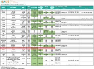

But In south korea, SK telecom network doesn't support PSM mode.
So I want to save power by LTE modem power off and on.
And Target application working scenario is just one-time data sending each day and power-off.
