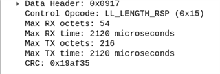

problem: in BLE data length negotiation , In the response from slave tx  doesnt go above 216, and rx doesnot go above 54.

If I try this:
err_code = sd_ble_gap_data_length_update(p_ble_evt->evt.gap_evt.conn_handle, &response, &lims);
and observe OTA using sniffer I see: from master
and response from slave as:
