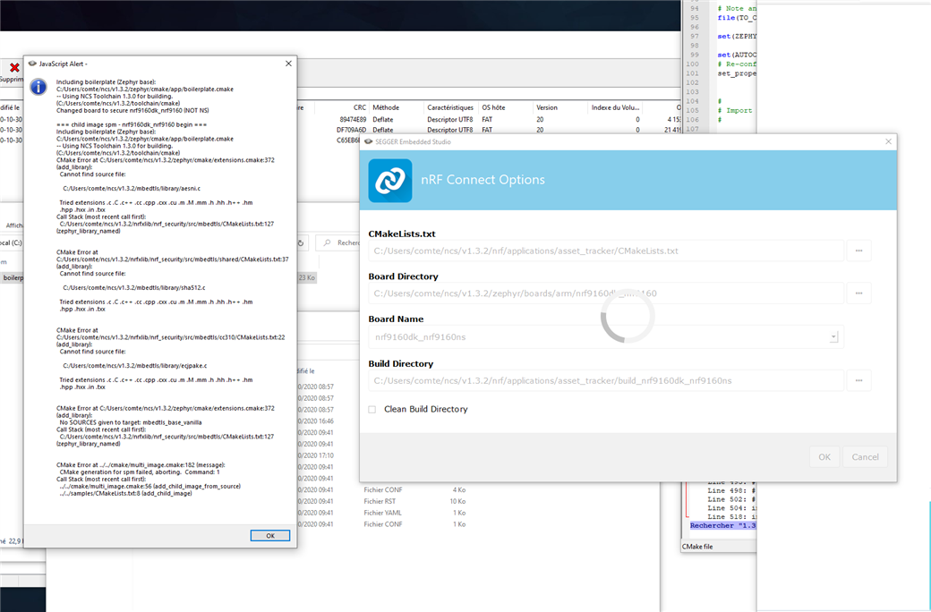

I just installed with toolchain manager ncv v1.3.2. When I try to open asset_tracker, it fails
Configuration:
Windows 10 x64 last version.
Configuration:
Neither me, nor several of my colleagues are able to reproduce this.
Could you try again, using a different build directory?
Could you check if the ncs/v1.3.2 folder contains everything it should (particularly the files in the error message)?
Are you able to build other samples?
