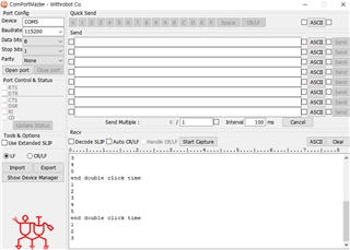

I am making a button double-click function in sdk v17.
I've tried 'app_button' and 'app_timer'. Created a timer that is called every 0.1 seconds and terminates when 5 calls(0.5sec).
This timer is to wait for the next button after pressing the button.
When the button is released, the timer is started, and when the button is pressed while the timer is running, it is recognized as a double click.
I don't think this method itself is bad. (Maybe...?)
But contrary to my expectations, it works strangely.  When App_button_release is called, the timer runs and it ends in 0.5 seconds. But it ends, and it runs again. And if I double-click, everything stops.

Can I get some advice or reference about double-clicking a button?
