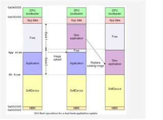

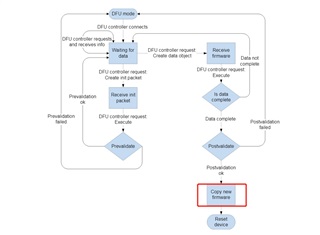

Please see Nordic nRF5x Bluetooth DFU upgrade firmware process.
If device is powered off at the step "Copy new firmware" and powered on again device goes into bricked state. It can no longer be accessed via BLE but only be accessed through J-Link SWI pins.
Is there any solution to handle this scenario?
Parents Reply
  • RahulR said:
    In this case, if application gets corrupted during copying new firmware, it should at-lease broadcast in boot-loader mode, right?
     Yes, worst case should be that the device falls back to DFU mode. I think the fact that it becomes bricked indicates that the bootloader is activating an invalid or corrupted application image. To get a better picture of what the problem is I think it would help if you could read out flash after a failed and succesfull DFU then compare the differences.
