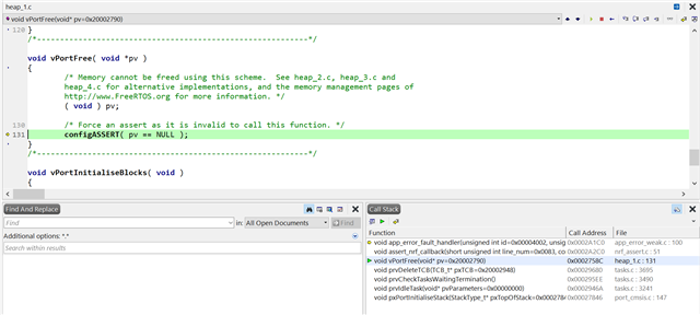

I am using the Nordic SDK 16.0.0 on an nRF52840 with FreeRTOS. I am quite familiar with using FreeRTOS, but hadn't needed to delete a task until recently. It seems that even when I create a simple task that deletes itself, I get an assertion on the vTaskDelete call. Is this a known issue or unsupported on this FreeRTOS port? I have referenced the FreeRTOS manual, and I am calling the function correctly. Nothing is done after the call to vTaskDelete, and it doesnt matter if I pass in the task handle or NULL (current task option), it still asserts.
An example assertion is shown in the screenshot of the call stack. Thank you
