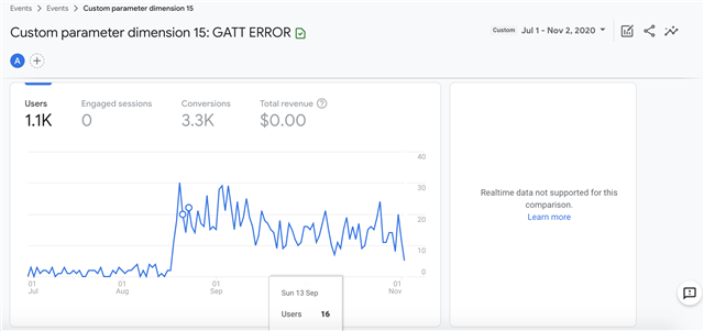

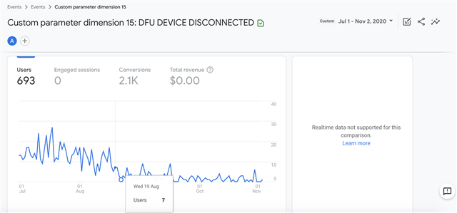

Hi there!
We faced the problem of not being able to perform Legacy DFU with Android 10 and newer iOS devices and have since applied the fix. However, since doing so we observed that there are more instances of GATT error. We have been monitoring DFU failures in our app and you can see a trend after applying the fix at around mid/end Aug, the DFU disconnected problem users decreased but GATT error users increased significantly.

    Thanks for your help so far. The problem is that we haven't been able to replicate the problem on our end and can only tell by the analytics numbers that GATT Error is something our users are experiencing. If we don't replicate the issue but still pass you the sniffer trace, would it still be useful? We are worried if this GATT Error snowballs into the DFU device disconnected problem we had.
