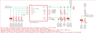

I would like to measure lithium batteries more accurately.
I'm measuring the value of a lithium battery (3.7V 110mAh).
I used SAADC to measure the battery power and it seems to be quite accurate. The charge IC also attempts to measure the remaining battery power even when the battery is being charged.
Similarly, although measured by SAADC, the adc value is almost constant, making it difficult to measure the remaining battery capacity.
This is a measure of battery value from 0% to 100%.
1) Battery charging: 580~600 (ADC value)
2) Battery not charging: 360~420 (ADC value)
The battery charges at 5V and initially the value is around 580 but quickly rises to 600 and almost stays at that value.

Is there a way to measure the remaining battery value accurately when charging the battery through the charging IC?

     With your SAADC configuration, I assume you have a gain of 1/6:
    Battery charging: (7.2V/1024)* 600 = 4.2V, typical charging voltage.
    Battery not charging: (7.2V/1024)*420 = 3.0V, way less than the expected 3.7-4.2V. Do you have the datasheet of the battery?
    Your schematic does not show what it is that you're actually measuring, but I assume Vbat and Vin are connected somewhere else in your schematics.
    I suggest you ask TI that question as well, given that they are the ones supporting their PMIC.
  • Hello, haakonsh.
    The person who made this board says that because of the addition of MOSFET to the battery connection, the power from the battery could be lower. (I don't know much about hardware, so I don't understand.)
    So if run the board with this battery, I can see that the LEDs on the board are definitely weak.
    Is the battery voltage inhibited affecting the battery value?
    Thank you.
  • If there's a 0.7-0.8V diode drop between the battery and the analog input then that would explain a lot. Do you mind sharing schematics for anything related to this issue?
    Either way you're measuring two different voltage sources, battery voltage under load and the battery's charging voltage. You probably can't measure the state of charge by sampling the battery's charging voltage, that's why you need to talk to TI. Most likely you will need to monitor one or more pins of the PMIC, if at all possible.
