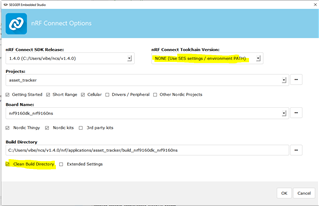

  • Hello Wright,
    I was not able to replicate this here. I'm also a bit suprised there weren't any errors except for the  create_nordic_project.py failed (1) error at then of their console output. Does the customer see this problem with other examples?
    Here's the console output I got for comparison:

  • Hi Wright,
    It was the "ModuleNotFoundError: No module named 'yaml'" that seemingly caused the build in the other thread you linked to. I don't see any similar errors in this case.
    Also, they could not do "west flash" command after they building it with "west build" command in all projects, here is the error log:
    nrfjprog must be installed separately following the instructions here: Installing the nRF5x Command Line Tools.
  • Hi Vidar:
    Thanks for your prompt reply!!!
    After they install nrfjprog command-line tools, they still can't do west flash.
    They solved the problem by installing "pynrfjprog python package".
    I'm wondering if there is any possible reason to show " error: cmake failed create_nordic_project.py failed (1)" when users complied NCS project with SEGGER?
    Wright
  • Hi Wright,
    create_nordic_project.py failed (1) is a direct result of the reported cmake error. What's strange is that cmake does not specify what the error is.
    Please ask them to try importing the project again but with the Toolchain version set to NONE as shown in screenshot below to see if it makes any difference. It's also important that they remember to tick the "Clean Build Directory" checkbox to clear the cmake cache.
     That's good to know. I actually didn't know it could work with the pynrfjprog package.
     Maybe they forgot to add its location to PATH. The installer does not do it automatically.
  • Hi Wright,
