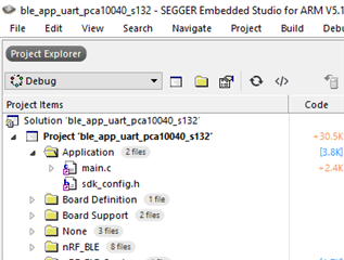

    Please try to compare you configuration with the peripheral ble_app_uart example. This example is set up by default to support MTU=247 and a 251 byte radio packet length. Also, are you calling nrf_sdh_ble_default_cfg_set() when initializing the Softdevice? This ensures that the Softdevice configurations from sdk_config.h actually gets applied.
    the app crashes with "fatal error",
    You should get a more detailed crash log if you build the project with "DEBUG" globally defined. If you use Segger embedded studio, ot becomes defined if you change from the Release to the Debug configuration.
