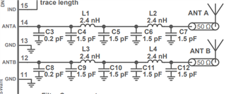

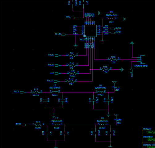

I want to extend BLE range from 200m ~ 500m using FEM.
For the first time, I choose SKY66111 but it is not working well because it has only PA module.
So I find out new FEM as your adivce, and it is RFX2411N.
 I modified my circuit design as follow :
would you review this circuit?
