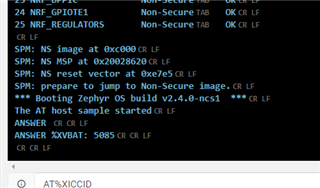

  • I modified your code a little and now it's working for me at least.

    	printk("The AT host sample started\n");
    	uint8_t buffer[100];
    	at_cmd_write("AT%XICCID", //AT+CEREG?
    			buffer,
    			100,
    			NULL);
    	printk("ANSWER %s", buffer);
    	at_cmd_write("AT%XVBAT", //AT+CEREG?
    			buffer,
    			100,
    			NULL);
    This is the response I get with your changes to the code,
    David

  • Hi again,
    Yeah, it seems I need to activate with AT+CFUN=1, before asking for the ICCID
