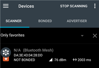

while scanning with nrfConnect app device is appear as
1. seems it does not support connecting to it, should it? to be able to connect and upload zip update
