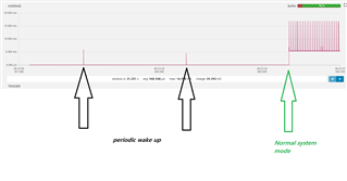

As i want to wake up each day, I'm using APP_TIMER instance. When i wake up, i just jump into timer_handler. But when i use my PowerProfile kit to monitor real current profile, i see that i'm consuming 6mA during this wake up step ! It bother me because, as i need to keep a good resolution for this app timer (around 1ms for the couting periode as 25ms interval period use app timer) , i can't use big prescaler value, meaning i will wake up around 6times a day, count if it is the sixth wake up , and then mesure. But during 5 wake up, i will consume 6mA just to increment and compare a counter ...
1.  How to reduce this 6mA to almost nothing. Is most of the 6mA comes from radio start ? Should i switch off this to avoid big cunsumption on timer wake up ?

    The CPU current is around 7 mA if you don't use the DCDC regulator (enabled with sd_power_dcdc_mode_set()). However, the periodic wake-up should have very little impact on the average current consumption, looks like it must be something else that's increasing the average in your case. Can you zoom in on the floor current between the "wake-up" spikes and see what the floor current is?

  • Here is DCDC enable:
    I hacve also connected directly my board on nrf PPK ( not through mux on my production board).
    Low power:
    Advertising current:
    Connected:
    Spike on the right are some reading with the phone.
    So imagine i need to refresh my characteristic each 100ms. Can I be still connected but with cpu in low power ? I'm not sure how softdevice and radio part are independent.
  • Could you please post your current implementation of main()? From your PPK plot it seems like the floor current goes up to about 6-7 mA as soon as you enter the advertising or connected state.
