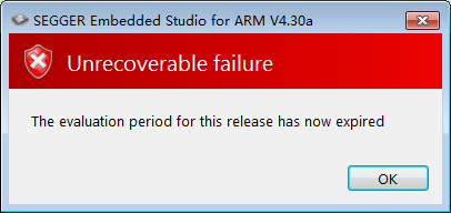

It seems that my SES is unregistered or uncertificated? How to fix it, I think this software is free for use.
You can obtain a SES license for Nordic devices here. Then go to Tools -> License Manager... to activate SES.
Br,
Einar
Hi Einar,
I cannot click menu bar when the SES popups this error. And then I click "OK", the software exits automatically.
Sean
I've viewed other questions same as mine, the solution is to update the software.
I cannot click menu bar when the SES popups this error. And then I click "OK", the software exits automatically. Is there a work around updating the license without going to Tools etc?
