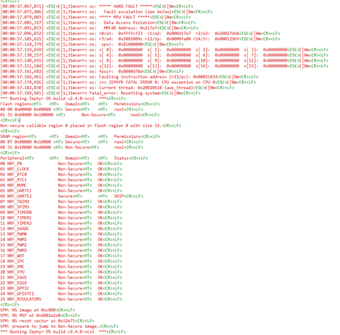

We need to handle multiple timeouts, to handle our processes, but we have a problem that we think occurs when our K_TIMERS expire. We are looking for restrictions on using multiple timers but we do not find any, the functions we are using are the following:
  1. k_timer_init(timer, NULL, NULL);
  2. k_timer_start(timer, K_MSEC(timeout), K_NO_WAIT);
And this is the error:
  • Is this a known bug?
  • Does anyone know of any restrictions that can cause this?
  • What could we be doing wrong?
Thanks a lot.

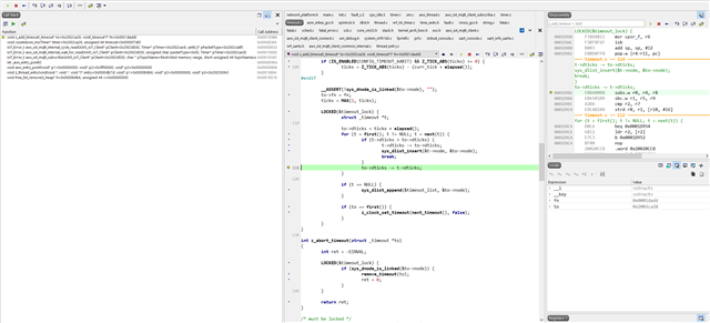

    In the assert message, you have two addresses that points out:
    And:
    What is located at these addresses? You can do a lookup using "arm-none-eabi-addr2line -e build-folder/zephyr/zephyr.elf 0xADDR". If you have re-compiled or done any changes to application, these addresses will move.
    Note that all k_timer instances are running in interrupt context, so you should be very careful of what you're calling in those callbacks. It is recommended to push tasks to a workqueue or similar instead.

  • Hi Håkon, thanks for your prompt answer, this is the result from the address mentioned:
    PS C:\...\build_nrf9160dk_nrf9160ns\zephyr> arm-none-eabi-addr2line -e zephyr.elf 0x217e7
    C:/.../ncs/v1.4.0/zephyr/include/sys/dlist.h:325
    PS C:\...\build_nrf9160dk_nrf9160ns\zephyr> arm-none-eabi-addr2line -e zephyr.elf 0x00021834
    C:/.../ncs/v1.4.0/zephyr/include/spinlock.h:92
