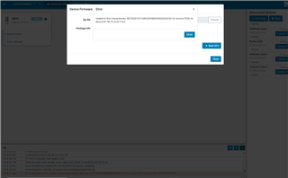

We are testing the combination of hrs example and the code in the butonless example.
When I tried dfu after putting the code together, this error occurred.
What does this error mean?
The specific UUID(0x8EC90001F3154F609FB8838830DAEA50) is the DFU Control Point. As this is missing, the DFU service is probably not (properly) initialized.
