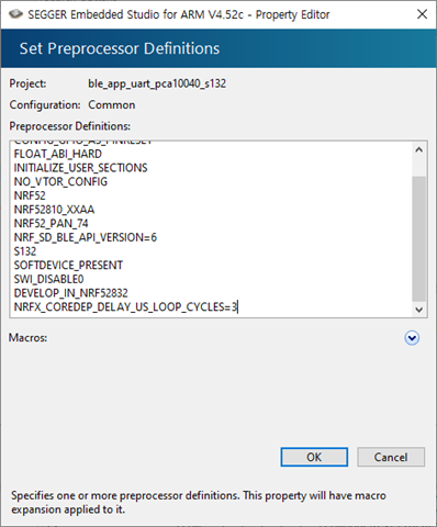

I am testing the PCA10040 example project & modifying.
I was checked that the project works well in nRF52832 board.

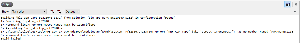

Now, I want to download the project to nRF52810 board.(While program downloading, it makes some error.)
So, I looking at the below document and trying to following steps.
1) I copy the exist project(PCA10040) and changing the device
Project - Debugger - Target Device - nRF52832 to nRF52810
2) I am remove the exist NRF52 and NRF52832_XXAA and add NRF52810_XXAA in preprocessor tab.
3) I add the ROM_END=0x2FFFF and RAM_END=0x20005FFF in the Section Placement Macros tab.
4) Remove the file _startup_nrf52.s and system_nrf52.c and Add of the 52810 file (.c, .s).
This is the steps which represented in the document, and the error like below is occured.
Which I can check or modifying? or Am I omit something in setting or file?
