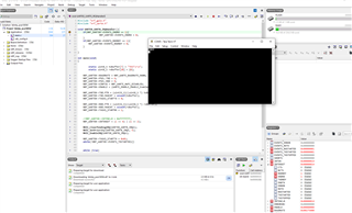

    I've changed my code. But it is not works at all.
    Normal reading is fine. Only the problem is Interrupt.
    UARTE0_UART0_IRQHandler() <- This code is not called at all.

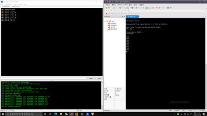

  • As you can see from the screenshot I posted, the program enters the interrupt handler in my case.

    I can't get any data from RTT viewer.
    What did I do wrong?
    *Modiefied attatched code.
  • I think it could be HW related seeing that the same code worked on my side. Were you testing this on a nordic or custom board? Are you using the Segger IC as the USB - UART bridge?
  • It is custom board. I use cp2104 as uart bridge. I can use normal UART interrupt, but the problems only happens when I use UARTE.
  • I cannot think of any good explanations as to why it works with UART, but not with the UARTE. Can you try to debug the app and check the peripheral event registers to see which events are set? Maybe EVENTS_ERROR is set instead.
