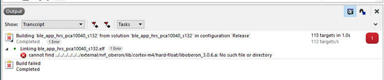

liboberon_3.0.6.a: No such file or directory
I am new to Nordic and Segger.  I am trying to build source code developed by a 3rd party.  It was originally developed with GCC in Linux.  I have followed some suggestions online to start with an example project then replace the source code with mine.  I started with the heart rate example.  After fixing all the compiler errors I got this linker error that I can't get past.  It is looking for a newer version of the file that is available in the SDK "liboberon_3.0.5.a"
I am using Windows 10, Segger Embedded Studio 5.10, nRF5SDK17009d13099.
