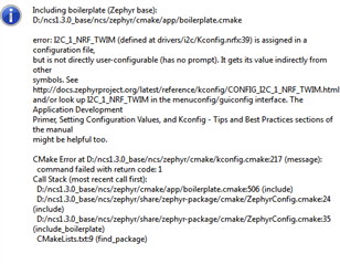

How can i use I2C_1 on nrf9160(ncs1.3.0)?
I want to use the four peripherals UART0, UART2, UART3, and I2C_1 on nrf9160. When I was building the project, I encountered the following error.
Here my prj.conf

CONFIG_I2C_1_NRF_TWIM cannot be configured. How do I set up my project to get I2C_1 to work. Thanks.
  • The problem has been solved.I just need to change the overlay.

    &i2c1 {
    	status = "okay";
    	sda-pin = <0>;
        scl-pin = <1>;
    	clock-frequency = <400000>;
    	da270@26 {
    		compatible = "mir,da270";
    		reg = <38>;
    		label = "DA270";
    		int-gpios = <&gpio0 2 0>;
    &i2c2 {
    	status = "disabled";
  • by default UART1 reserved for modem traces. if you use i2c1 then you cannot use urat1.
