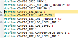

i2c_nrfx_twim: Error 195952641 occurred for message 0
It works when I use I2C_2 to communicateon nrf9160. The register value is successfully accessed when i2C_reg_write_byte() is called.
9160dk_9160ns.overlay:
&i2c2 {
	status = "okay";
	sda-pin = <0>;
    scl-pin = <1>;
	clock-frequency = <400000>;
	da270@26 {
		compatible = "mir,da270";
		reg = <38>;
		label = "DA270";
		int-gpios = <&gpio0 2 0>;
I want to change I2C2 to I2C1.
Modified overlay:
&i2c1 {
	status = "okay";
	sda-pin = <0>;
    scl-pin = <1>;
	da270@26 {
		reg = <38>;
		label = "DA270";
&uart1 {
	status = "disabled";
The following error occurs when i2C_reg_write_byte() is called to access the same register of the slave machine:
The code is the same and I haven't changed it. Why is this a problem?
