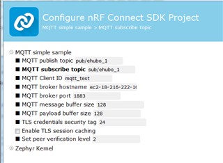

    My setup is as follows.
    Project settings for Thingy91, as an example:
    I configured publish/subscribe topic,mqtt client id and broker to point at our AWS instance.
    The AWS instance is running Mosquitto MQTT broker. I launched a mosquitto_sub client which is subscribed to the unit's topic and prints the messages that it receives to a log file.
    mosquitto_sub -h localhost -t "pub/test" -v | while IFS= read -r line; do printf '%s %s\n' "$(date)" "$line"; done >> pub_mqtt.log
    Additionally, mosquitto_pub is set to publish a single message to the unit every hour.

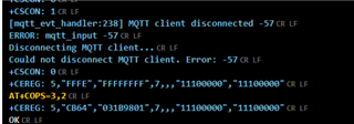

    UPDATE:
    Running mqtt_simple on the nRF9160 DK with LTE Link Monitor running in the background yielded this error:
    2020-11-16T06:03:59.412Z DEBUG modem << Received: abc
    2020-11-16T06:03:59.415Z DEBUG modem << Publishing: abc
    2020-11-16T06:03:59.418Z DEBUG modem << to topic: pubs/ehubo_1 len: 12
    2020-11-16T06:03:59.466Z DEBUG modem << [mqtt_evt_handler:238] MQTT client disconnected -57
    2020-11-16T06:03:59.468Z DEBUG modem << ERROR: mqtt_live -57
    2020-11-16T06:03:59.469Z DEBUG modem << Disconnecting MQTT client...
    2020-11-16T06:03:59.470Z DEBUG modem << Could not disconnect MQTT client. Error: -57
    2020-11-16T06:04:06.106Z DEBUG modem << +CSCON: 0
    Could this be the problem? The unit is still connected to LTE and the AT commands returned good results as seen in the logs.

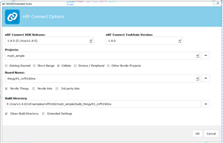

  • I am testing the DK at the moment.
    First flipped SW5 to program the nRF52 with: nrfjprog --program nRF9160_DK_board_controller_FW.hex --sectorerase -f nrf52 -r --verify
    Then flipped SW5 back to program the DK.
    Since I could not find proj.conf in Segger, I modified the proj.conf directly within the folder C:\ncs\nrf\samples\nrf9160\mqtt_simple and added CONFIG_BSD_LIBRARY_TRACE_ENABLED=y as shown in the instructions.
    I then closed the Segger project and re-opened/re-configured all MQTT settings. As always, I use the board name nrf9160dk_nrf9160ns to open the mqtt_simple project.
    After programming, I opened LTE Link Monitor and ran AT%XMODEMTRACE=1,2 which responded with OK.
    I then opened Trace Collector and it remains at 0 bytes without incrementing.
