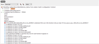

Hi, I am attempting to flash various bluetooth samples onto the nRF5340pdk, and I am getting errors on multiple levels.
First, when I attempt to build the samples (I have tried with 4 of them now) in nrf/samples/bluetooth to the network core of the nrf5340, I get the following error:
This specific case is for central_uart. I don't understand why this error occurs. When I build the same application to the application core of the nRF5340, it succeeds in building the program. However, when I then attempt to flash this hex file to the board itself, an error occurs that requires me to recover the board.
Here are the logs when I attempt to flash peripheral_hids_mouse (specifically the zephyr.hex file):

Please let me know if there is any more information needed.
  • Hi Benjamin,
    For Bluetooth Low Energy, the nRF Connect SDK provides the Bluetooth: HCI RPMsg sample. This Zephyr sample is designed specifically to enable the Bluetooth LE Controller functionality on a remote MCU (for example, the nRF5340 network core) using the RPMsg Messaging Protocol as a transport for Bluetooth HCI. The sample implements the RPMsg transport using the OpenAMP library to communicate with a Bluetooth Host stack that runs on a separate core (for example, the nRF5340 application core). See the network samples documentation.
    For the programming error issue, Please try the latest version of the nRF-Command-Line-Tools. If it still cannot fix the issue, run the following commands, and provide the logs.
    nrfjprog.exe --coprocessor CP_NETWORK --recover --log NETWORK.log
    nrfjprog.exe --coprocessor CP_APPLICATION --recover --log APPLICATION.log
    -Amanda H.
