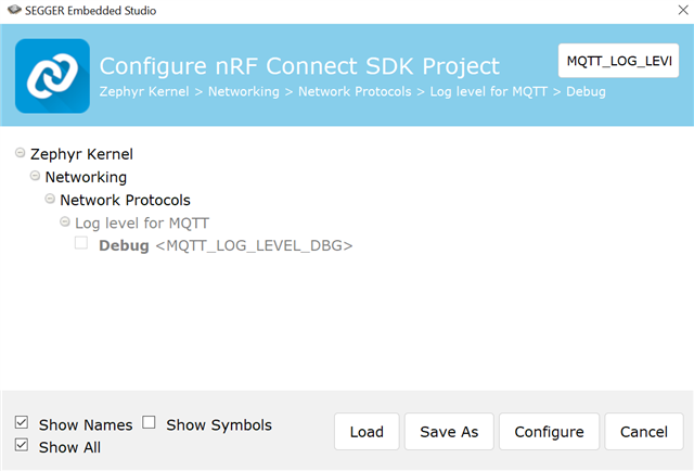

  • Hi, I cannot enable MQTT_log_level_dbg from the NRF configure. Can I enable it from the Kconfig file?
    I was connecting to broker.hiveqq.com
  • Yes, just add "CONFIG_MQTT_LOG_LEVEL_DBG=y" to the prj.conf file of your application and build.
