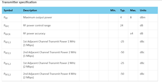

We are going through regulation certification testing.
And lab is asking what is power tolerance for BLE 1Mbps for the chip.
Where can I find this value?
I think it's the RF power accuracy number you are after, is so then the nRF52810 has a RF power accuracy at ±4 dB.
See this page, https://infocenter.nordicsemi.com/topic/ps_nrf52810/radio.html#unique_1626162569.
