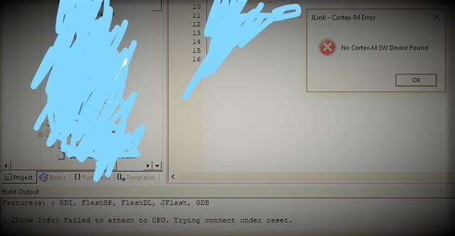

Dear Member,
I compiled ant_bsc_rx_pca10040_s212,
but when I uploaded to the chip I got these error below,
It said I didn't connect the board wiith M4 chip,
It's already connected and tested with other code and uploaded properly,
What's missing here ? thanks
Program Size: Code=18604 RO-data=4280 RW-data=380 ZI-data=10340
FromELF: creating hex file...
".\_build\nrf52832_xxaa.axf" - 0 Error(s), 0 Warning(s).
Build Time Elapsed:  00:00:10
Load "G:\\nRF5_SDK_17.0.2_d674dde\\examples\\ant\\ant_plus\\ant_bsc\\bsc_rx\\pca10040\\s212\\arm5_no_packs\\_build\\nrf52832_xxaa.axf"
Set JLink Project File to "G:\nRF5_SDK_17.0.2_d674dde\examples\ant\ant_plus\ant_bsc\bsc_rx\pca10040\s212\arm5_no_packs\JLinkSettings.ini"
* JLink Info: Device "NRF52832_XXAA" selected.
JLink info:
DLL: V6.30h, compiled Mar 16 2018 18:02:51
Firmware: J-Link ARM V8 compiled Jan 31 2018 18:34:52
Hardware: V8.00
S/N : 20080643
Feature(s) : RDI,FlashDL,FlashBP,JFlash,GDBFull
* JLink Info: TotalIRLen = ?, IRPrint = 0x..000000000000000000000000
Error: Flash Download failed  -  Target DLL has been cancelled
Flash Load finished at 00:01:22

  • When I tested with uart_pca10040 project, it can be uploaded properly, the log :

    What's missing here ??
    It looks like you are trying to connect over JTAG. Our devices does not have JTAG support.
    Can you try to go into the debug settings in the IDE and switch to "SWD"?
    Håkon
  • Hi Hakon,
    Thanks for the reply,
    I connect with SWDIO and SWCLK....
    it works with other project, only doesn't work with this one, any clues ?
  • Are you sure that you have switched this in the project settings of your IDE? When it reads TotalIRLen and such variables; its trying to communicate in JTAG.
    Have you tried updating your JLink driver? It seems very old.
    Håkon
  • I am facing the same issue. can anyone know what is the reason behind this?
