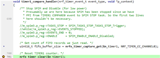

    I break in the TIMER1 compare handler (so COMPARE0 has happened, and therefore PPI CH[2] should have stopped SPIM3):
    and here are the SPIM3 registers:
    Even if I uncomment the TASKS_STOP trigger at the top of the handler, it still doesn't stop. The only way it stops is if I disable SPIM3 in the handler.
  • So I think I finally grok the problem here.  Kicking off the STOP take for SPIM does nothing if SHORTS are still set.  Somehow you have to disable SHORTS, which I'm guessing requires software intervention?  I disconnect it first thing in my TIMER1 COMPARE0 handler, but I still get a two byte overrun since SPIM is still running in the background.  I can just discard this data for my purposes here, but is there a better way?  It feels like there should be a DISCONNECT SHORTS task in SPIM, or some other equivalent but I'm not finding it.

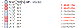

  • Just had a look at the nrf52840 Product Specification and section 6.5.30 "Registers" indicates that TIMER0-TIMER2 have 4 CC registers, and TIMER3-TIMER4 have 6 CC registers.  So COMPARE5 doesn't exist for TIMER1.  Why not try COMPARE3 and see if that works, or try COPMARE5 with TIMER3 or TIMER4? (BTW ii seems remarkable to me that CH[2].EEP reads back "0" when you wrote 0x40009154 to it (where TIMER1.EVENTS_COMPARE[5] would be, if it were to exist)..... I can't begin to think how that might be implemented in the silicon?)
    BTW2, I noticed in your debugger output that SPIM3.SHORTS = 0x0020000, which means "Shortcut between event END and task START".... so maybe in fact your COMPARE0 really is stopping SPIM3, but as soon as it ends then this shortcut immediately restarts it? (EVENTS_STARTED also shows "1")
  • Just had a moment of inspiration to solve the SPIM SHORTS problem.  Instead of using SHORTS, I just made a new PPI channel from SPIM END Event to SPIM START Task, then added is to PPI CHG[0].  Then I added a FORK to PPI[2] to trigger a PPI CHG[0].DIS Task, thus disconnecting the short from SPIM END to SPIM START.
