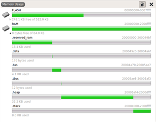

I can initialize the library without problems. In the sdk_config.h it comes with MEMORY_MANAGER_SMALL_BLOCK_COUNT = 1 and MEMORY_MANAGER_SMALL_BLOCK_SIZE = 32 by default. Obviously this does not allow me to create larger amounts of memory to store my data. So I have tried to enable MEMORY_MANAGER_XXLARGE_BLOCK_SIZE, but I get the following error:
error: section .heap overlaps absolute placed section .stack
Sorry, but I don't understand the error as I know I have enough space in the heap to create that memory block.

Memory usage:
