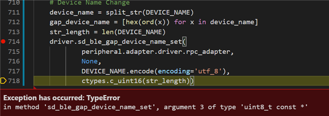

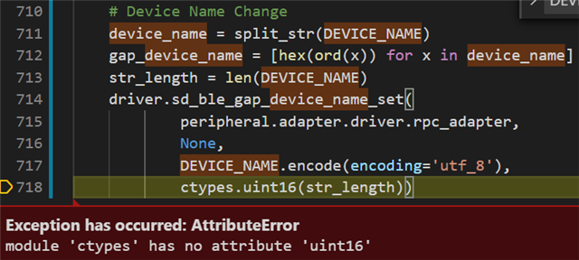

In my script, the function is used as follow:
    # Device Name Change
    device_name = split_str(DEVICE_NAME)
    gap_device_name = [hex(ord(x)) for x in device_name]
    str_length = len(DEVICE_NAME.encode(encoding='utf_8'))
    driver.sd_ble_gap_device_name_set(
            peripheral.adapter.driver.rpc_adapter,
            None,
            DEVICE_NAME.encode(encoding='utf_8'),
            str_length
when in Debug mode with Visual Code, I receive this message:
Can anyone help me to solve this issue?
