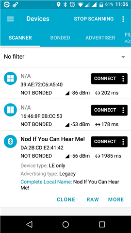

  • Hello again,
    In the advertising example, there is a useful method, very simple than mine:
    adv_data = BLEAdvData(complete_local_name="pc_ble_driver_py")
    and then
    driver.ble_gap_adv_data_set(adv_data)
    So, using those lines of code in my script
        adv_data=BLEAdvData(complete_local_name="Nod If You Can Here Me!")
        peripheral.adapter.driver.ble_gap_adv_data_set(adv_data)
    and the result is:
    Nevertheless, even if the result is the desired one, the advertising data previously entered and displayed for the Manufacturer Data with this method disappear...
    That is great, I am happy to hear that you found the example useful!
    That is because you with the first line is creating a new - empty - instance of the BLEAdvData class, to which you only provide the complete_local_name variable.
    If you would like to use this approach to change only the device name - and keep the previously provided advertising data the same - you will need to keep records of the other data currently being advertised, and provide that along with the new name to the new object. Try this, and let me know if you are able to update the device name this way.
    You could then create a function that does all this for you, to which you only need to provide the new name ( if you intend to change name often ).

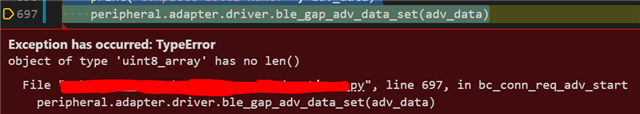

  • Hello Karl,
    Ok, I grabbed the concept, but I'm afraid I'm starting to get lost...
    So, my target is to set Complete Local Name and Manufactuer Data at the same time and I have stored this last one in list, for example:
    # Manifacturer Data
    data = ['0x2', '0x1', '0x6', '0x12', '0xff', '0x59', '0xfe', '0xba', '0xcc', '0x53', '0x72', '0xaa', '0xdd', '0x55', '0x37', '0x6f', '0xcc', '0x55', '0x33', '0xaa', '0x66', '0xff']
    adv_data_manufacturer = util.list_to_uint8_array(data)
    where list_to_uint8_array Converts a python list to uint8_array.
    After that, set this array and name:
        # Complete Local Name and Manifacturer Data Set
        adv_data=BLEAdvData(complete_local_name         ="Nod If You Can Hear Me!",
                            manufacturer_specific_data  =adv_data_manufacturer
    Running this script, there's this exception:
    Looking at the function ble_gap_adv_data_set , len() is not an input parameter...
        @NordicSemiErrorCheck
        @wrapt.synchronized(api_lock)
        def ble_gap_adv_data_set(self, adv_data=BLEAdvData(), scan_data=BLEAdvData()):
            assert isinstance(adv_data, BLEAdvData), "Invalid argument type"
            assert isinstance(scan_data, BLEAdvData), "Invalid argument type"
            (adv_data_len, p_adv_data) = adv_data.to_c()
            (scan_data_len, p_scan_data) = scan_data.to_c()
            return driver.sd_ble_gap_adv_data_set(
                self.rpc_adapter, p_adv_data, adv_data_len, p_scan_data, scan_data_len
    Probably it's something that I'm missing, and still don't understand... Is that what you've tried to explain me?
    Even though I'm starting to have a terrible mess in my head Scream, I'm able by the way to set or the Manufacturer Data or the Local Device Name
    Thank you!
    Fabio
  • Hello Fabio,
    You are absolutely on the right path here! :)
    Normally, if you were to implement an interface between a C program and a python program on your own, you would be absolutely correct in your approach here!
    Fortunately, the pc-ble-driver-py does this for you. If you look into the particular function being called here - peripheral.adapter.driver.ble_gap_adv_data_set - you'll see that it takes an BLEAdvData object as its first parameter. Then, in this function, it checks whether it in fact is a BLEAdvData object, before calling the objects own .to_c() function. Looking into this function, you see that .to_c() actually does this very conversion to a uint8_t array, and returns both the pointer to the start of the array, and the length of the array.
    So, what you are doing wrong in your case is that you have provided the BLEAdvData with a uint8_t type array for its data already. This does not work, since BLEAdvData is a python object, which does not expect to work with uint8_t types. Instead, you should provide the data as usual to your BLEAdvData object, and let it do the conversion to uint8_t for you only when needed.
    In essence, the pc-ble-driver-py is created so that you do not in fact need to know that much C, to work with the SoftDevice(which is entirely in C).
    So, when working with pc-ble-driver-py, you can just go ahead and think of it strictly as python, and it will do the necessary conversions for you in the background, without you needing to intervene.
    The reason why you in your initial post had to look into uint8_t types ( and other C types ) is that you were trying to use the sd_ble_gap_device_name_set function directly, which is a C function.
    In conclusion, if you stick to using the supplies pc-ble-driver-py API, then you do not need to worry about C types and C conversions happening behind the scenes.
    I hope that what I have wrote makes sense. Please do not hesitate to ask if anything about my answer should be unclear! Slight smile
